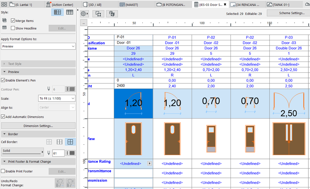

How to reduce the door dimension font in the door schedule without having to open the annotations one by one

You can go into the 'annotate' mode and edit each separately.
Or just choose the size you want in the dimension settings, and turn off the automatic annotation and turn it back on again to re-do the dimensions.

thank you its work
