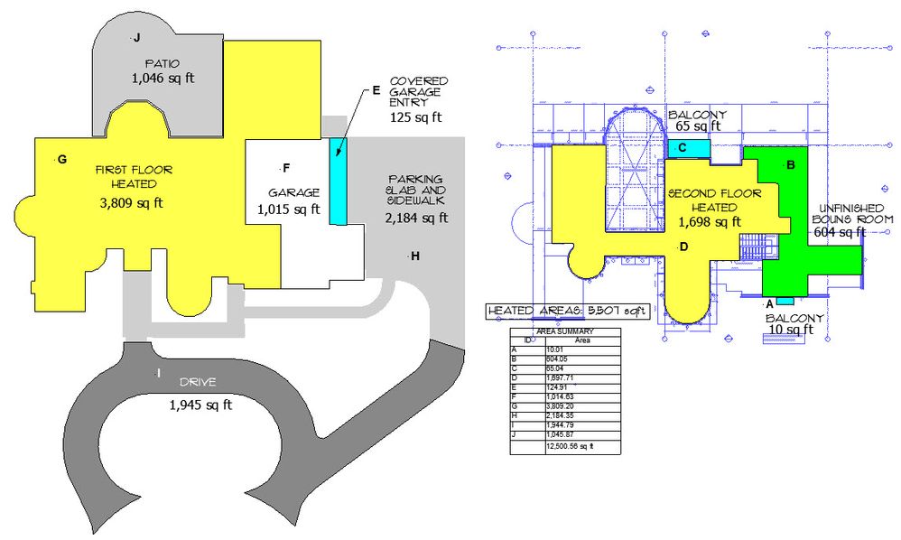

Steve Jepson
PaulS wrote:
I would like to have an auto-summed list of areas taken from an elevation. my guess is that it cannot be done? I work in both v16 and v17. is there a work-around??? thanks.
You can use a Trace Reference of what ever it is you want to know the area of.
The Trace Reverence can be temporarily moved to where ever you want it and you can trace it with a fill to get the areas into an Interactive Schedule.
Like Edwardo, I also assign an ID to the fill. And I add an ID Label so that drawings of the fills will match the schedule.
It helps to use a %25 fill or similar with no background so it is transparent while your placing the fill over a Trace Reference and you can see what your doing.
Of course there are other ways to get the surface areas of things into an interactive schedule but they are not always so verifiable or accurate as this less sophisticated way of doing it.
For example, surface areas the siding. The siding may extend above the top of the wall up to the bottom of the top chord of the trusses with a raised heel. Also, the siding may extend down below the bottom of the wall to cover the rim joist and mud sill + just a little.
There are many situation where you can reduce the amount of modeling you might have been doing strictly for the sake of schedules that is not necessary if you are getting your surface areas this way.
There are lots of ways to use this technique.
See attached image.
