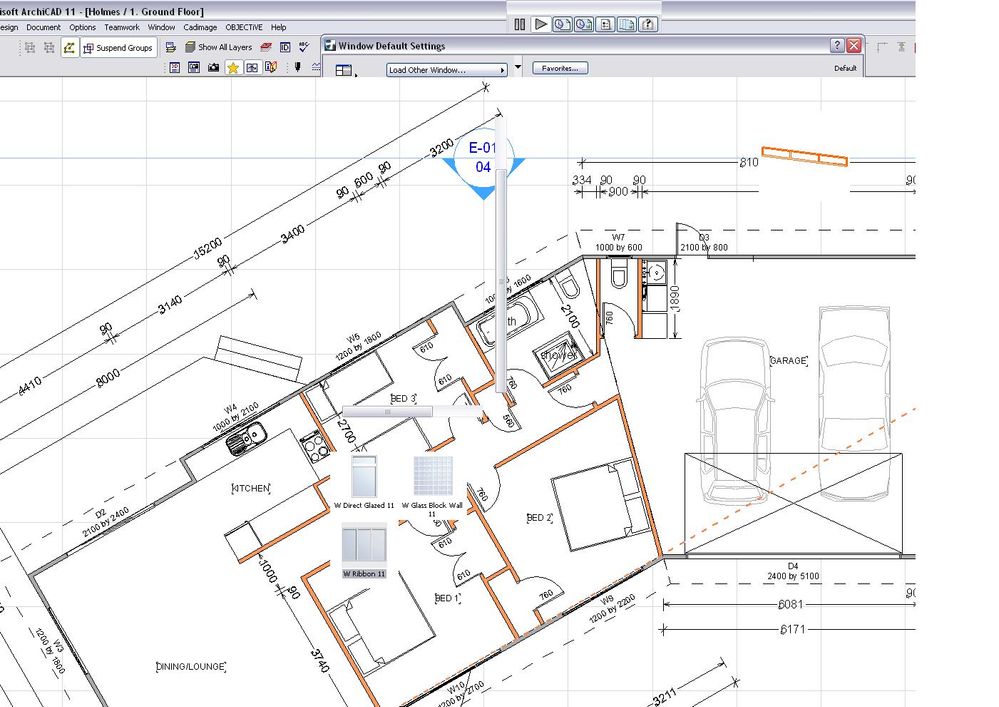

Hi all, Could someone who is using AC 11 on XP x64 with a Nvidia card tell me your version of card drivers that are working successfully for you. I'm using 94.24 and my drop down menu's are disappearing behind floor plan window. Thanks

Hi - with very latest graphic drivers, AC11 works on Vista 64 - but OpenGL performance still sucks quite badly for ArchiCAD and pretty much anything else - both speed and quality suffer, even on a high end machine. WinXP 64 is significantly better for OpenGL

Hi, Just further to my problem I changed to a Quadro FX 560 with latest drivers and still getting screen problems. Nearly unusable. see screen shot. Any suggestions

I suspect you may need to bite the bullet & either switch to an Ati card (Is it too late to return your NVidia, based on non performance under Vista?), or for best results switch to XP64
Depends how patient you are - it could be many months before a usable Vista driver emerges, assuming one eventually does (ArchiCAD is likely not on the list of applications that drivers are tested under)
Just to check the obvious though - as a test, you could try a fresh install of Vista on another partition, and install drivers from scratch, and thus test ArchiCAD OpenGL performance under a "virgin" environment

Hi Paul, I am using XP x64. Also AC 11 dose this on a XP x32 machine.AC 10 dose work on XP x64 but it also has a display problem of the screen blinks all the time, when editing mostly, in both XP x64 and x32 with Nvidia cards and ATI cards. I have never had a stable (screen wise) AC 10 or now AC 11. AC 9 was always trouble free, so haven't been impressed with the last two releases for me anyway. It is very annoying having to use AC with these issues. Don't know why and have run out of ideas. I thought the Quadro might have solved it with a different sort of driver but no change. Anyone with any suggestions or at least seen this behavior before?

Firstly, what CPU are you using ?
How much RAM?
Can you play new 3D games without problems?
Do you have an onboard vidio card on your motherboard, and is this safely disabled in bios?
Hard to know what is causing your problem without seeing this "blinking" and what you are doing when it happens, but typical troubleshooting steps I would use in this sort of situation:
Update your motherboard bios.
Then make a clean install of windows XP64, then install latest downloaded motherboard drivers and graphic card drivers, then install ArchiCAD - nothing else at this stage
If you still get blinking etc, then you may have a dodgy motherboard or faulty PCIe bus
