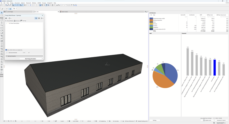

Graphisoft Center Danmark just released a public beta version of DesignLCA, a plugin to AC 26 that facilitates Eco designer star, in order to calculate a projects CO2 footprint throughout a given period of time (CO2eq/m2/anno)
DesignLCA calculates the "Global Warming Potential" as an "Early stage LCA"
With this method designers can (fairly) easy get a reading of your projects CO2 footprint where both construction and operation is taken into consideration.
There´s a Danish version, prepared to meet the danish regulations that will be implemented in 2023.
There´s an international version where vaules and settings needs to be adjusted to meet your local regulations, demands and EPD´s .

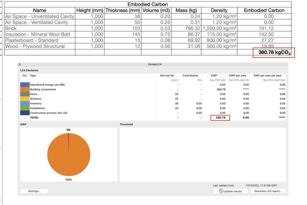

Thanks Thomas, I've got it to work now and your plugin values match my schedule. I think the issue was that I had the service life set to 0 in some of the materials. Setting it to 1 throughout has fixed that. I'll keep playing with things and let you know how I get on.
Do you have any recommendations for good sources of generic embodied carbon data? We're UK based. At the moment we just want to quickly compare design options at the concept stage to determine which is likely to perform better from a carbon point of view, but without having to get get too detailed about materials. Thanks again, Nik

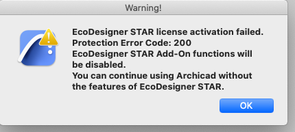

1) When i open the file an error message says " EcoDesigner STAR License activation Failed, Add-On functions will be disabled"
The evaluation Report can be done though.
2) When i try to use DesignLCA plug-in to go further in the analysis, i can find the plug-in on the tool bar at the top of the screen, but i can't use it because when the Energy Model Review window is open and i click to export the energy simulation, i dont have "Export to DesignLCA"
Thank you for your help,
Hugo
2022-11-18 10:07 PM
Hi Hugo
Are you sure you have the very latest update for Archicad 26 (build 4019)?
// Thomas
2022-11-18 10:13 PM
Oups you re right. Its 3001. Will it also work for USA Version ? Which means imperial units ?
Thank you very much,
Hugo
2022-11-18 10:42 PM
Good question 😬

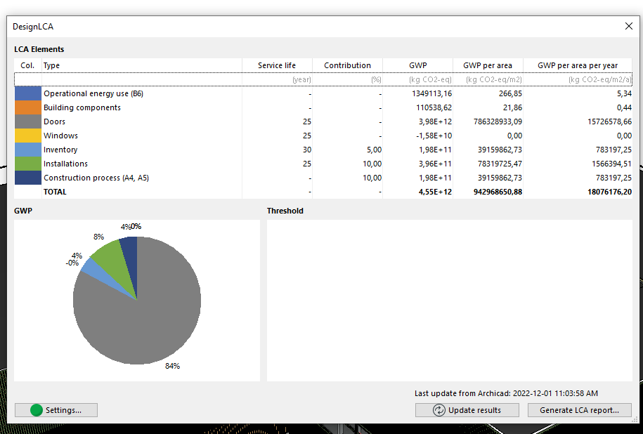

Thanks for sharing! However I have few questions :
-I've been trying with it a little bit and I'm getting unrealistic strange values with E* and very high values for doors, unlike the screnshots I saw on top, do you by any chance know why ?
-How does it calculates for doors and windows ? or where does it take the values from?
-Since there's no layer compination to select, does it calculates the whole elements in the file or for the current elements that are showing in the 3d view ?
Best regards.
