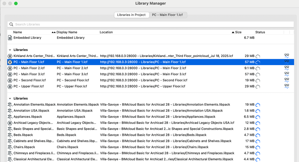

John Adams
This solution may be correct but does not work well for point clouds that require and LCF file. I don't want to project specific load point clouds into the BimServer libraries. I want the point cloud library to be "locally" available, like the embedded library.
So for me this process with the BimCloud libraries is not a good solution.

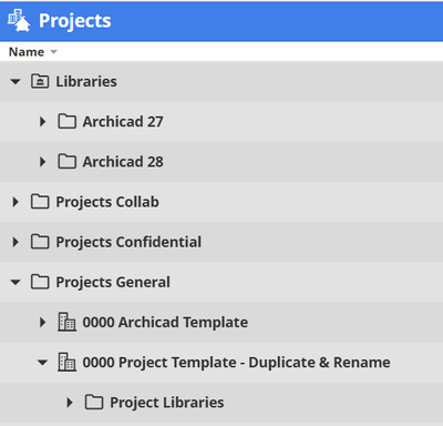

Davor P
Good practice is to have office wide libraries in a central location, then create a project library folder inside project on BIMcloud. Anything project specific - add there.
