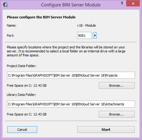

This is probably dumb - but where do I find what my BIM server Address is so I can enter that into ArchiCad so I can share my project in Teamwork?

Based on the screenshots that is the correct procedure. Next steps is to hit Start and configure the server.
One item to take in consideration is that you need a "Fixed IP address" in the for ox XXX.XXX.XXX.XXX if you computer is using a dynamic address then you every time it changes you will need to re-configure the BimServer.

You are not finishing the setup process. When configuring the Bimserver by clicking on start you will be prompted to create an ADMINISTRATIVE ACCOUNT which is the user name and password that you will use to log in when clicking the BimServer icon. Also you will need to register your bimserver and for that you need the GS account.

Ejrolon, Finaly...i found the solution....
The problem so simple indeed...that is because of my default browser..
so my step is :
01. Uninstall another browser
02. Change IE (Internet Explorer) as my default browser
03. After hit "START" then configuration page for new administrator user appear in IE browser successfully...
After that i can install another fav browser....n run my BIM server
Big thanks for ur answer n time Ejrolon...................................
