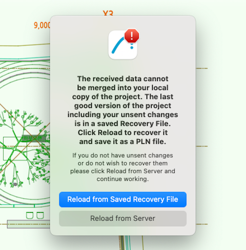

Archicad 29 is unusable due to Teamwork errors. Please review a measure to provide a partial refund
Archicad 29 is unusable due to Teamwork errors. Please review a measure to provide a partial refund of the Archicad 29 subscription fee.
Hello.
This is the first time in 14 years I have had such a terrible experience.
The client computers are Macs. The server is Windows 11.
The time servers are all identical, set to time.apple.com. (I even attempted to unify the time on the Windows server using the UTC method, but it was of no use.)
The error shown in the image below appears 3 to 4 times a day, causing about 30 minutes to an hour of work to vanish each time. I am suffering significant financial loss.

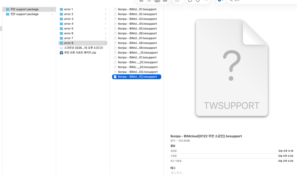

I received a response telling me to clear the cache files and test again.
If the cache files are the problem, then why does version 28 work perfectly fine without issues?
Please take a look at what I have gone through over the past 2-3 days.

Lee, I see this error about 15+x a day.
I don't know the volume of users you interact with, but I've seen this exact warning dozens of times across multiple offices, ranging from 2-3 practitioners up to 80+.
It has crippled some projects. One firm I consult with has gone from an average of 44 hours of overhead per month office wide to 154 hours non-billable/overhead in January and 102 hours in February.
So, count yourself lucky that you've only seen it rarely.
I have gone through the paces. Clean up the file. Clear the local data. etc. etc.
I have heard from graphisoft: it's probably your libraries, its probably your attributes, its probably your file SOMEWHERE. The hard truth is, this WAS an occasional issue through 2025. Once my clients switched to cloud service and AC29, it is a daily struggle.
I'm here to commiserate with the OP... this is a BIG problem. I have clients asking me to run evaluations on what it would cost to transition away from Archicad... I don't know Revit, but I'm running out of reasons to ask them to stick with Graphisoft.
I am thankful I have a team at Graphisoft helping me sort this out and look for a solution; but until I stop hearing how it's my client's fault, their files, their computers, their server configuration... until Graphisoft takes 100% ownership of the ****show that is BIMcloud in the year 2026, I have no argument when they tell me they want to move to Revit.
If archicad has teamwork errors because of local data problems, or libraries, or attributes, or polygons, or... then it is a teamwork problem. it is an archicad problem. it is a graphisoft problem. it is NOT an end user problem. We don't write the software. We aren't all expterts in how the software works. And we shouldn't have to be. BIMcloud has to work for all of us, not just those with the patience to deal with teamwork warnings or those lucky enough to not have them at all.

case in point, these are a daily interaction since bimcloud SAAS + AC29:

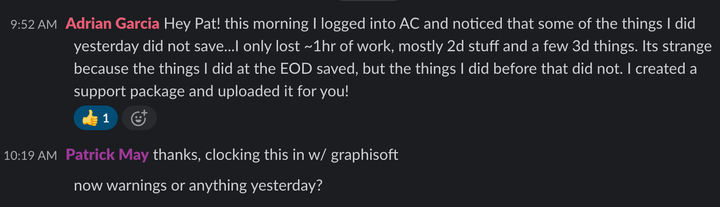

its not jsut the warnigns, it bimcloud failing to sync with local data. local data randomly being overwritten by server data. hours or even days of work just vanishing without warning
