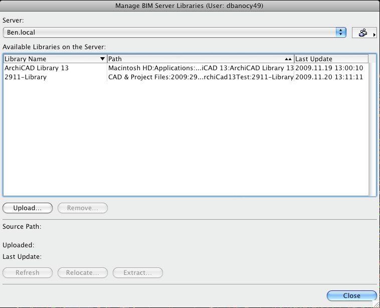

I have a problem that I have not yet seen posted...I migrated a file from AC12 thru creating a .pla file of the original teamwork file (I have also tried via simply sharing the .plp after opening in AC13, with no luck either). Once I open the file and share it, I cannot figure out how to gain access to the default AC13 Library.
I have uploaded the library thru the BIM Library Manager dialog box to the BIM Server. Here, I also see my extracted .pla file's library already loaded. When I open the Library Manager dialog box, all I see is my .pla extracted library, but not eh default AC13 Library. I have tried reloading, refreshing, removing and replacing the default library with no luck.
In testing and working out issues, I have set up the BIM Server on an unused machine on our network. It is running 10.5.8, but no server os. I have admin access. Everything at this point seems to be fine, but I can't seem to take advantage of the default library.
Any thoughts? Thanks in advance...

In Library Manager, to the right of the huge "Add..." button, notice the tiny button with a triangle on it. Click that ... browse to your server and add the AC 13 library. (User interface at its friendliest. Not.)

also though...when all else fails, read the directions...i've done some dumber things in the past...i recently realized this by reading an excerpt from the archicad help menu...don't forget, you have to reserve the libraries first in a teamwork situation...

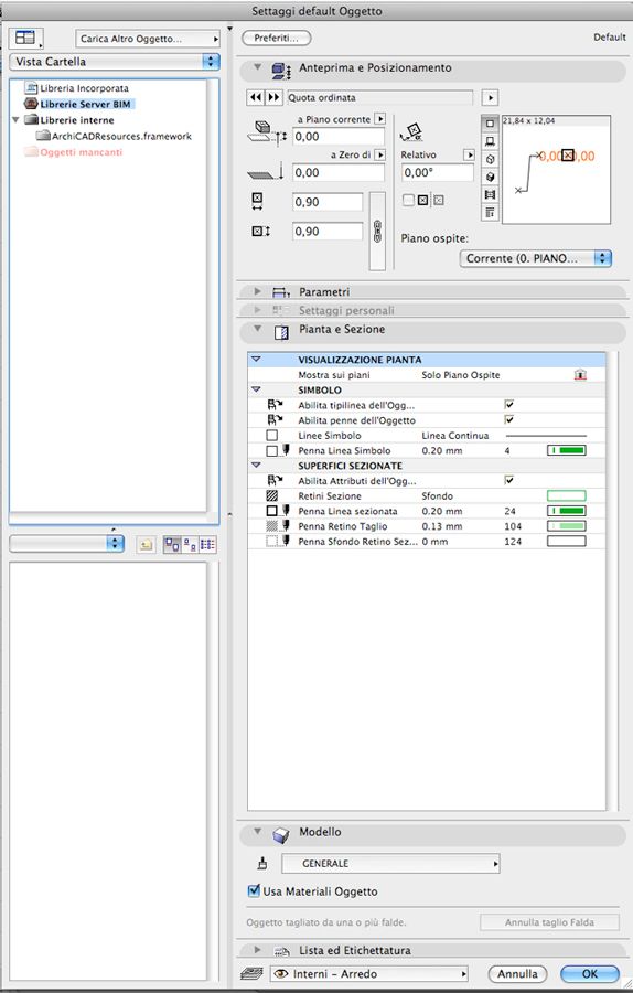

What if I've done all that and we still can't access our libraries?
We had a project that we were working on from two different computers, one AC13 one AC12... sharing the file over our network. We upgraded the AC12 to 13 and decided to give teamwork a try. Uploaded the server and all appropriate libraries. But we have missing objects everywhere, and no ability to add new objects. In the BIM library manager window, our libraries have been uploaded. In the Library Manager for the file, they are not listed under BIM Libraries, nor can we add them anymore. Whereas you used to be able to 'chose' a library, it now asks us to 'open' and 'open' and 'open' until we get all the way down to specific elements.
going crazy here. HELP!

In the Library Manager Window, there is the Manage BIM Server Libraries button.
If you click it, you go to the Manage BIM Server Libraries Dialog, where you can login to the BIM Server and it will list the available libraries.
You need to select the Library in the list that you wish to add to your project and click the Add button. That will take you back to the Library manager Dialog and the library you just added will be listed under BIM Server Libraries. Then you need to Reload Libraries.
Is this what you are doing?

That is exactly what we did. Our libraries are listed correctly under the BIM Server Libraries in the Library Manager Dialog. We reloaded the libraries.
Then, when we want to create an object, in the Object Settings Dialog, where you should be able to search through the libraries - you cannot. They are not listed.
Any ideas?

Can you post a screenshot or two about this?
So you are saying that the library is loaded but the elements within the library are not listed in the Object Settings Dialog?
dearmariana
Sure - Our interface is in Italian, so sorry if I get the English names of things wrong...

... and here's the Object Settings Window
