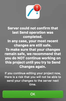

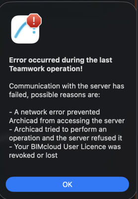

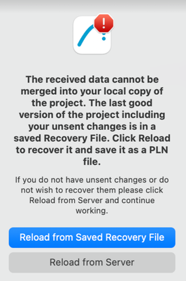

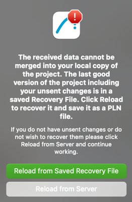

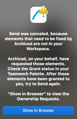

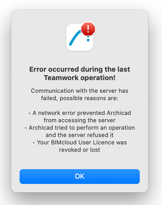

BIMcloud warnings are getting out of control
here is a small sampling of the t/w warnings I have been trouble shooting the past week. This feels like something is broken... or theres something else at play here (my tinfoil hat is on pretty tight right now). And these are about 1/4-1/2 of what I've been sent:
