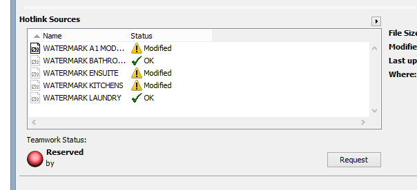

in one of our Teamwork projects we are having an issue where certain elements/controls are reserved by no one, and we cannot request these elements.
See attached screenshot showing Reserved By_________ with no name shown.
Also no users are showing in our Teamwork Palette, even tho we have 5 people working on the project at one time.
A little more investigation has us thinking this is more linked to the fact that no TW projects are showing any users in their "USERS" pane of TW Palette.
Users are showing on the BIM Server.
This all started after a power outage that caused the Server to crash.
Has anyone had these issues before, and/or does anyone have a solution for it.
Thanks.

ok we have worked out a solution.
When I say 'we' I mean our IT guy. I personally have no idea how all this works!!
Disclaimer:
“As with anything in Terminal, make sure that you know what you’re doing, and always backup first”
The issue is a corrupt messages.db file which can happen with improper shutdowns, stops of the service, or other corruption.
1. Stop the server
In terminal, execute both commands below.
• sudo launchctl unload /Library/LaunchDaemons/com.graphisoft.PortalServerService-v18.0.plist
• sudo launchctl unload /Library/LaunchDaemons/com.graphisoft.TeamworkApplicationServerMonitor-v18.0.plist
2. Open Finder and navigate to Applications -> Graphisoft -> BIM Server 18 -> BIM Cloud Server 18 -> Mailboxes and delete mailboxes.db
3. Reload the services by executing both commands below in Terminal.
• sudo launchctl load /Library/LaunchDaemons/com.graphisoft.PortalServerService-v18.0.plist
• sudo launchctl load /Library/LaunchDaemons/com.graphisoft.TeamworkApplicationServerMonitor-v18.0.plist
