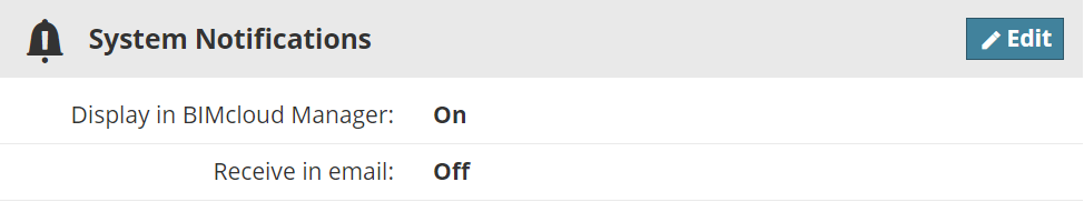

To receive notifications on the user interface and have the system send an e-mail as well, enable the Notification System related settings for all affected users as shown below. Make sure the SMTP settings are set and working, else the option to "Receive in email" will be disabled.

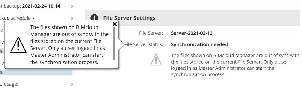

First of all, make sure you are logged in with the Master Administrator (masteradmin) user to be able to sync between the BIMcloud Manager and BIMcloud File Server.
Server administrator users (or any other users with full access on the Servers page) will receive a notification in case they attempt to sync.

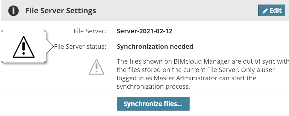

  2. Navigate manually to the Servers > BIMcloud Manager > Settings > File Server Settings panel.
  3. Click on the "Synchronize files..." button to start synchronization between the servers.

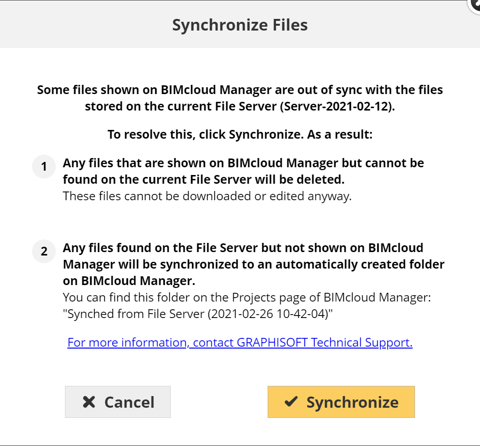

  4. A warning appears, summarizing consequences of the synchronization.
    • Any files that are shown on BIMcloud Manager but missing from the current File Server will be deleted.
    • Any files found on the current File Server but not available on BIMcloud Manager will be synchronized to an automatically created folder on BIMcloud Manager, showing the date of synchronization. E.g.: "Synched from File Server (2021-02-25 10-30-49)"
  5. Click on Synchronize to start the synchronization process.

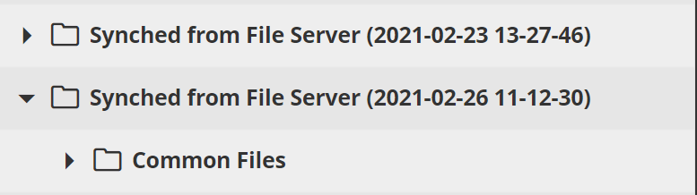

  8. On the Projects page a new folder with the date of synchronization is created, with the content coming from the BIMcloud File Server.
