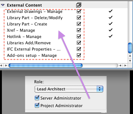

Rod Jurich
fuzzytnth3 wrote:
/... signed out and signed back in as myself. /.....
Fuzzy, see attached. I am not sure I understand you when you say
"signed back in as myself"
If you are sharing your project I would set as shown.
