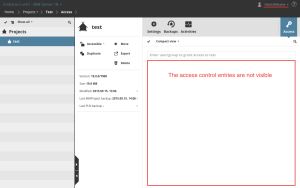

Issue
Projects' access control list is not visible and cannot be modified in the BIM Server Manager web user interface.
Cause
If there are overall 100 access control entries or more in the BIM Server Manager - for all projects - the access control list disappears and project's permissions cannot be modified anymore.
 Important notes
  • If there is a user who has custom settings for a project, every permission row is counted as an access control entry.
  • Every project has an access control entry by default which allows everyone to access the project with their default role.

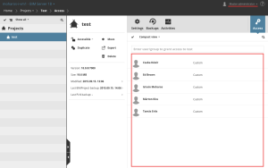

Solution
Although BIM Server users cannot see the access control list, the masteradmin user can still manage the permissions. Log in as masteradmin to see and manage the projects' access control settings.
wp-content_uploads_2015_09_BIM-Server-Manager-Access-Control-with-masteradmin-300x188.png
 Note: it is expected to be fixed in v18 Update 7007 and v19 Update 4011.

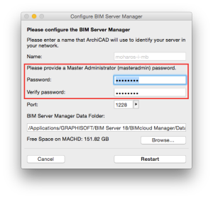

What is the masteradmin user? The masteradmin user is set during the BIM Server installation's configuration phase. This user is made for troubleshooting and it has full access to the BIM Server Manager.
How to change masteradmin's password To change the masteradmin's password, start the BIM Server Manager's configurator and set a new password. For the default location see the paths below. Windows C:Program FilesGRAPHISOFTBIM ServerReconfigure v18 Manager OS X /Applications/GRAPHISOFT/BIM Server/Reconfigure v18 Manager
