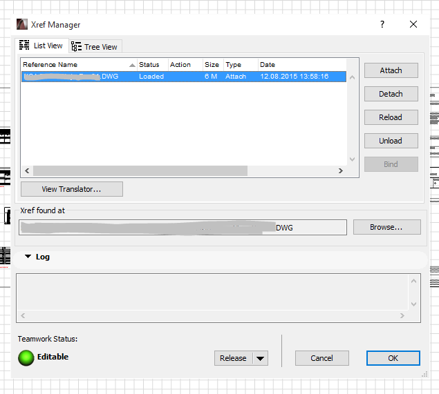

Hi there,
I tried to attach a dwg and bind it to Arhicad 18. Normally it worked fine but in a teamwork the bind button it's grayed out.
I have lead architect role in bim server and reserved all.
If you have any ideea how to bind it please share.
Thank you!

This is just a guess:
The screenshot says the XREF is loaded. But I think it should be attached, meaning it needs to be placed. Then, when it is attached, the Bind button should be enabled.
I hope this will work for you.
This is normal status "loaded" and type "attached"
I guess the only workaround it's to open a new archicad bind it in it and copy paste it to the teamwork...

This is a known issue. In version 18 there is no bind or similar function to explode an XREF in Teamwork because of technical reasons. We are working on this issue to find a long term solution.
As a workaround I suggest that bind the XREF in a solo PLN file and copy it back to the Teamwork project, or save the Teamwork project to PLN, bind the XREF then share the project again.
