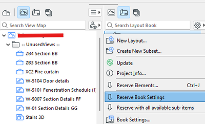

I have recently started using the Teamwork function and keep running into the issue of spending too much time trying to figure out what needs to be reserved to do various things that I resort to reserving all...
One of these places is in details, where I get a message saying "You must first reserve this viewpoint". That is even after I have reserved the detail, the detail marker and the entire drawing that contains the detail marker... Why is there not simply a button on this message asking if I would like to reserve this viewpoint?
The other is with Transmittals. There is no reserve button, so... but I do not need everything reserved to edit it? I select Reserve All, then do not request any currently reserved items and it lets me edit it. What hidden item am I reserving?

Regarding the Transmittals, you need to reserve the following three:
  • Book Settings - right click on top of the Layout Book: Reserve Book Settings
  • Change manager - Only if you want to amend the changes, but you do want to.
  • The layouts to be issued.
Out of these three, the Layout book settings is the most important, without that you cannot create Transmittals.
Regarding the your issue with details, the viewpoint is a separate entity from the detail itself, therefore you need to reserve it separately, if you want to edit that. If you are new to Teamwork, or ArchiCAD, it might take some time to get your head around what is what, but I'd say these are important to be familiar with.
