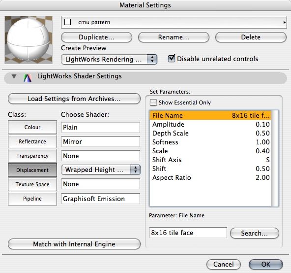

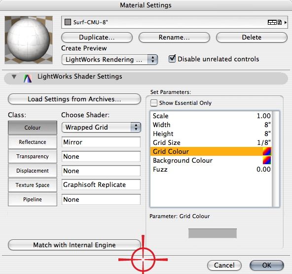

Could anyone direct me to a link containing a WHITE-PAINTED 8" CMU texture, please? Or, better yet, is there a way to duplicate and modify the existing "Surf-8" CMU" material to look like it is painted white in a LightWorks PhotoRendering? I've played with numerous settings in the LightWorks Engine menu of the Materials window with no successful results.

There's many things that COULD be done, but the most direct fix you can apply is to change the Colour Shader as indicated in the attachment.
Make the grid light grey and the background white.
Increase light reflectance until the tiles get bright enough.

Color shader PLAIN = white
Dwight Atkinson
Dwight
Here's the wrapped height map. Unzip and save to the library - then reload.
Dwight Atkinson
Dwight
here's the height map/displacement setting
Dwight Atkinson
Dwight
here's the result.
