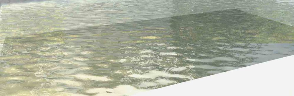

AC 9 Water rendering tip for LightWorks
Decrease water transparency from 32 - 72 for improved reflection

Really nice Dwight.
Is that a reflection map that you have used on the water?

Dwight
That is a modified [increased opacity] LightWorks material as applied to the waterwave object - a poly mesh of adjustable amplitude - reflecting the actual background elements of the scene.
So, unlike the old days, we didn't need to cheat.
LightWorks allows for control of five aspects of material quality, including a sort of fuzzy blob opacity that is ideal for mapping a water surface.

Dwight
here
Dwight Atkinson
Dwight
blobby reflection
Dwight Atkinson
Looks great Dwight. Just tell me this: if i saw it correctly on the screenshots, that`s "Water 3" material. And in Archicad 12, i have only 2 water materials. Have made a new one (duplicated one of this two) with your own texture? If that is the case, wich texture have you used?
Thanks.
Dwight
I called it water three since the first two were taken.
There's no image texture - this is a shader with two classed defined.
It will only show in a LightWorks rendering - you must use a rendering of the water surface made straight on for an image in OpenGL renderings.
