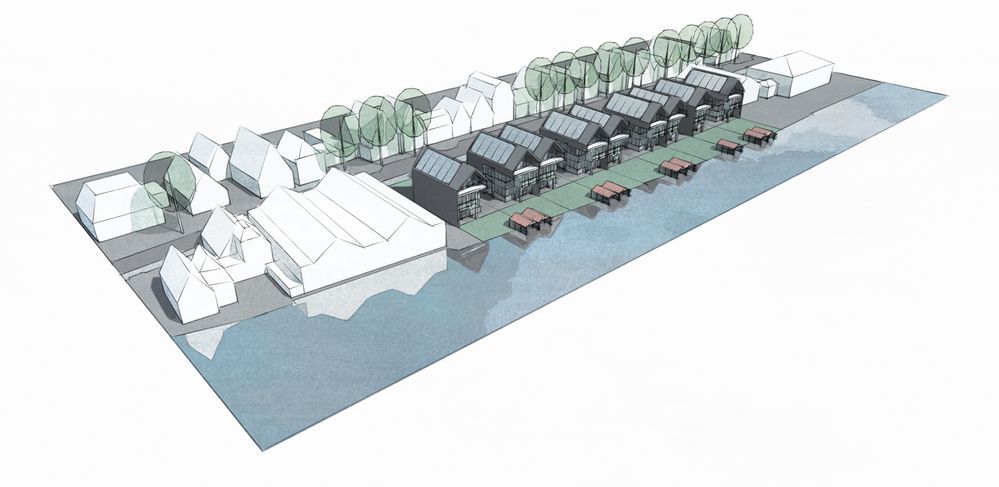

Erwin ... how is that picture done? Is it done with the sketch engine + "effected" color rendering?
eng. Alessandro Mandala - Italy
AC27 latest hotfix
Win 11 Pro 64bit
Ultra 9 275HX 64GB GeForce RTX 5070ti
Erwin Edel
Rockstar
Photoshop layer effects.
top layer is a tone/saturation/brightness tweak where I tone down the saturation 20% and the brightness up by 5%
under that there is the sketch render set to multiply, in this case 100%
next I used a white model render to subdue all the colours a bit, I put it 50% bleach
then for the real 'magic' Modern Watercolor effect from SparkleStock https://www.photoshoptutorials.ws/downloads/photoshop-actions/free-download-3-awesome-actions-create... I adjust some settings from the final effect as it comes in too blue/oversaturated to my taste. I just want the cinerender to looks less crisp.
bottom is my cinerender
only use the watercolor effect with cinerender layer visible.
Takes about 5 minutes to render and combine in photoshop.
I prefer this over photorealism during the design process. It invites the client to talk about design. Some people don't dare talk about changes if it looks like the project was already built.
