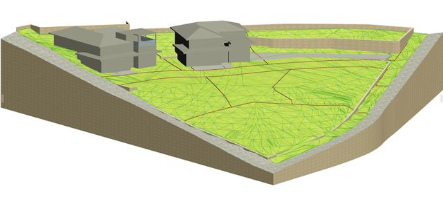

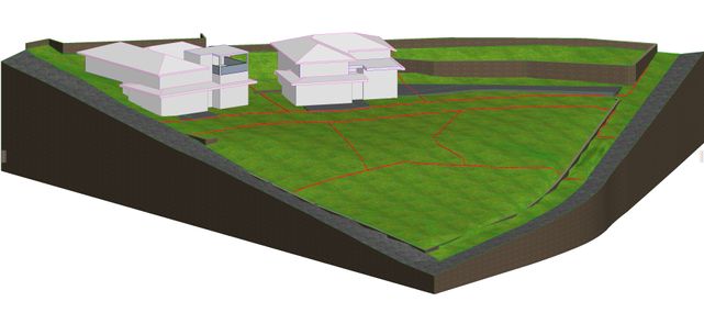

Migrating a project from 26 to 27 I noticed something strange: my 3D window shows inaccurate colors from what was shown in 26. Also, a couple of colleagues working in ArchiCAD 27 had it shown correctly.
See below: First is PBR turned ON and colors are incorrect
Second is PBR turned OFF and colors are correct
(see signature for my computer specs)
After my investigation I found that I had to turn OFF the PBR materials setting in the Work Environment.

Is it something to do with the computers video card type and settings maybe ? PBR having the sun more prominent and to cause the shadows. All the best trouble shooting this issue.

Not sure. I'm on an M1 Max MacBook Pro, so it's the integrated GPU. Not like I'll use ArchiCAD for rendering anyway, so no need for PBR textures. But I'm sure many may run up against this.

Sounds like a software issue with AC27. Is it happening with a migrated project or a new one from scratch ?

It is the PBR it is still not at an usable stage. Turn it off and forget about it.

Yup. That's what I did. I posted incase others have this issue and can't figure out why.
