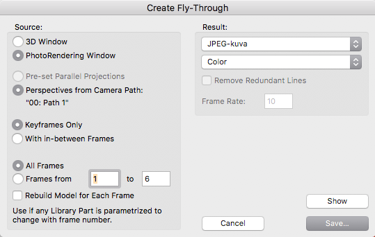

Another and very quick way is to just create a fly through from your camera path, but render and save the key frames only.
First adjust Render options as you want them, then,
Document - Creative Imaging - Create Fly-through:
x Photorendering window
x Keyframes only
Result: jpg picture
Save...

Hi mikas,
also great and easy way to export images. Thank you both.
