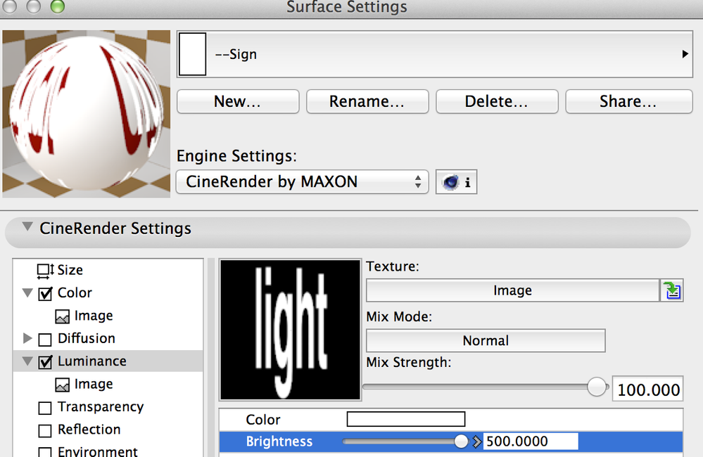

Here's the trick with 2 different JPGs, one for color and one for illumination

Eduardo Rolon
Don't forget to use " Match internal to C4D" and to turn Illuminating Surfaces on and in this case it is set to 200

Eduardo Rolon
With the same JPG on both color and Luminance

Eduardo Rolon
and painting the white area yellow

Eduardo Rolon
For the JPG make sure it has the same proportion as the Morph.
In this case the Morph is 16'-0" by 4'-0" so the JPGs are 8" by 2" at 72 DPI this will ensure that you don't slow down the file by having huge images in the Library.
Karl, render time should be a fraction of using Volumetric lights in this samb=ple it was rendering in 8 secs a 600x800 image.

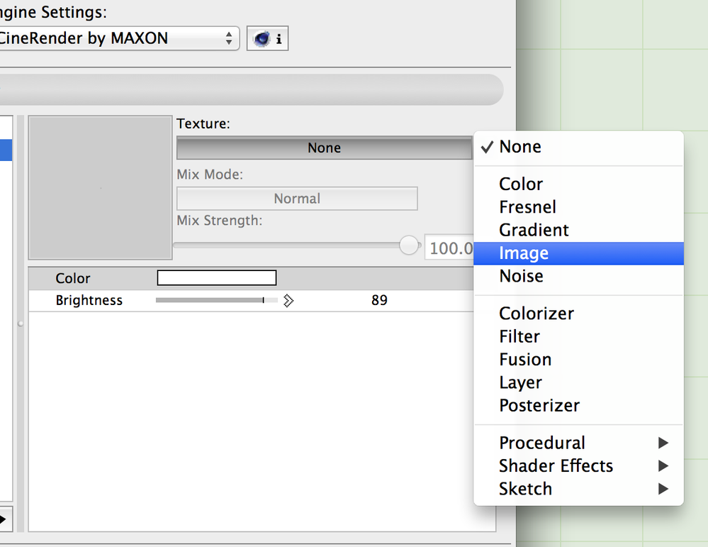

Eduardo Rolon
Open Options-> Element Attributes->Surfaces
and select New
On Color or Luminance Select Image as the type

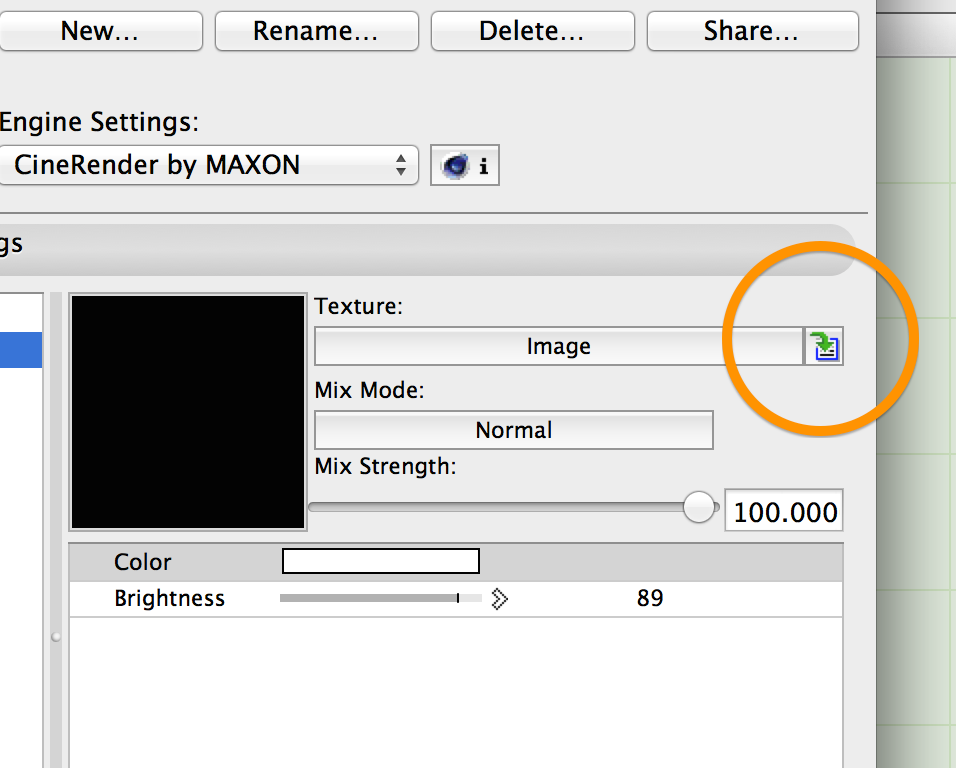

Eduardo Rolon
Click on the "Sub Setting" icon

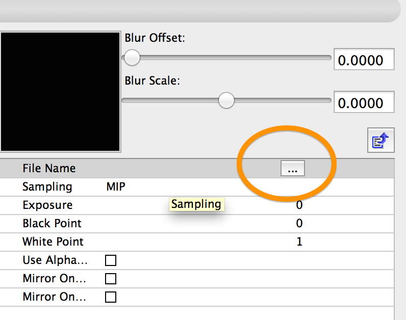

Eduardo Rolon
Click on the ellipsis icon
Eduardo Rolón AIA NCARB
AC28 US/INT -> AC08
another Moderator
Eduardo Rolon
Click on "Load Other Picture"
Select "From File Dialogue"
then go look for the JPG were you saved it or have it stored.
Repeat for the other channel
