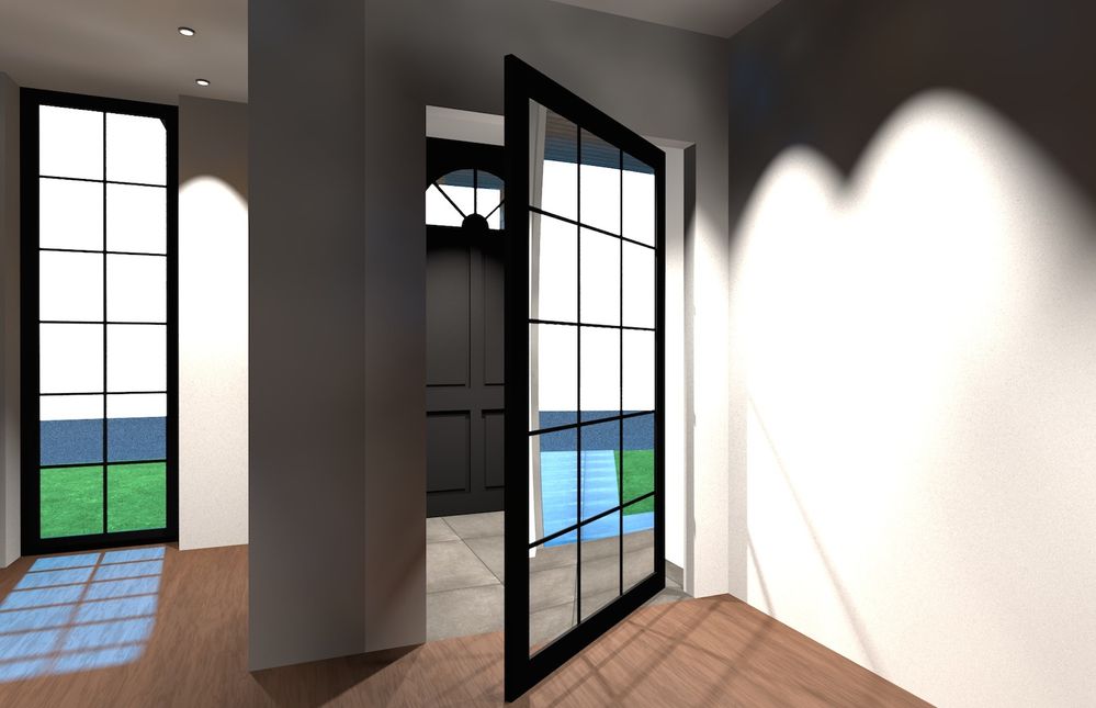

Hi!
Is there somebody who knows why my interior door with glass acts as if he's placed in an exterior wall? I can see what is behind my front door in the exterior instead of the reflection of my interior.. Nice special effect but nog what my clients want to see 😉
I'm new at using Rendering in archiCAD 18.
Probably it's just a setting?
Thx in advanced!

Check the environment channel of the Surface that you use for the glass.
The following video explains how to create such, I think this needs to be disabled for your scene: https://www.youtube.com/watch?v=zdtyxwpwsXY&index=8&list=PLnXY6vLUwlWVsI6mb8Txb6MYZ4wdGdvaA
