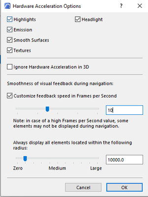

Is open GL no longer available in archicad 26?
Vlad174
The hardware acceleration option looks very unnatural and

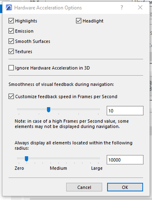

Since Archicad 25 it has been called hardware acceleration.
it stills has the same settings.

The change was just a UI simplification due to iOS moving to Metal.
MinhNguyen
Yes. From Archicad 26, Direct3D replaced OpenGL as 3D graphics API, similar to the change from OpenGL to Metal on macOS

OpenGL/DirectX is only active during navigation in 3D. If anything, DirectX should be better in terms of efficiency/performance. If you consider only the performance when navigating in 3D, basically any modern discrete GPU can handle most projects (given that it's cleanly modelled) with ease.
When it comes to rendering, Archicad uses Cinerender. Previously it only utilizes CPU calculation, however Redshift (part of Cinerender engine) now enables you to render with GPU, which should be faster/give better-quality images. Of course, this means that better GPUs take a shorter time to render, however, it will require you to have some knowledge of Cinerender to be able to fully utilize the power of Redshift.
