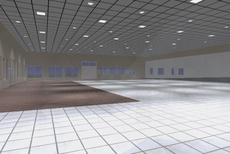

Here is the scene with a wide light cone down. Attached is the rendering.
Sunlight 100%
Ambient light 100%
Lamps on
Light cone down 80%

Where I'm going with this is to direct you to making the light cone down larger (and softer) by adjusting its Light Cone Radius similar to the settings on page 68 of the book where I show how to light an entire room using just one light cone down light source.
You might start by looking in the light Settings for the light cone down - increase the light cone radius to 20 or 30 feet.
Make sure your light stops value is bigger than the room.
Incidentally - the suspended fluorescent fixture contains a light cone down that can be expanded beyond the fixture for softer light. I see that you have several of these lights in the ceiling already.
And use the LightWorks engine, not the internal engine.

I took another shot of the other side of the room. Please comment.
undefined
Dwight
use fewer, larger light sources. Make them wider.
Post your individual settings.
