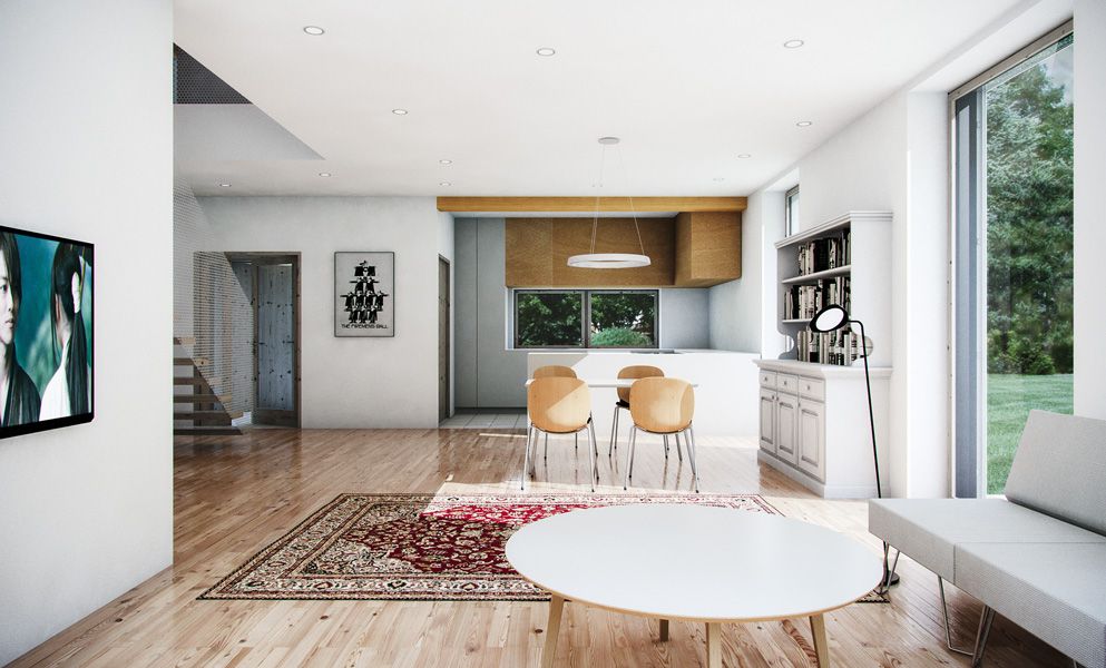

Someone has to be first. I have modeled in AC17 and rendered in AC18. Some post in PS. I am happy with the result.
Great render,considering that it came direct from AC (plus a bit of tinkering in ps) ! Have you used other renderers in the past, if yes then what's your oppinion on AC's implementation of Cinerender engine?
I think that it is quite powerfull, but again I see a big fail on the Graphisoft side that no guide was provided, and the implementation is poor. Few tutorials would help a lot to set up workflows. I find the AC almost good for interiors (very bad handling of non gdl objects such as 3ds models of furniture etc - one hi-poly lamp can freeze the AC 3D engine with ease), but for exteriors it is just substandard. No camera tools (even 2 point perspective is not possible - the real one like the shift in photography), no 3D foliage, slow grass etc. Somehow almost every new tool in AC nowdays is halfbaked when introduced so probably in the future it will get better. I can show few other renders with a little different settings, I am happy with them, but I would love to use more external non gdl models.
You are right about non-gdl objects with high poly count.
The sofas in your render would make a huge difference if they had enough detail in them.
Either way, great renders,keep 'em coming!
