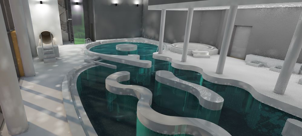

This time I had 65 light sources total. A FullHD 1920x1080 render took several hours, depending on settings. I did adjust the settings quite a lot this time trying to find a good combination, so I can't tell exactly what those are/were. It's too tedious to write them down here, sorry. The settings were towards the upper quality of everything, though.
And these renders almost ate up all of my memory. I have a bunch of older Macs here, and 32GB was barely enough, 48GB was sufficient, but my poor PC (pleas see signature) did not make it with 24GB of RAM. It just quit with "not enough memory".
The picture attached probably had at least very close to one hundred light sources (done with ArchiCAD 18 couple of years ago). You can't see all lights/lamps at once, they are in the pool room back there, they might have their impact on GI and intensity of overall lighting, I don't remember exactly what settings I put in there. These and a few similar renders took something like overnight to finish at FullHD and WQHD, and at 5K it was a matter of hole day or a day and a half to finish. They used RAM a lot too, 16-32GB became very handy.
I believe that you can't have too much working RAM with higher end rendering settings.
