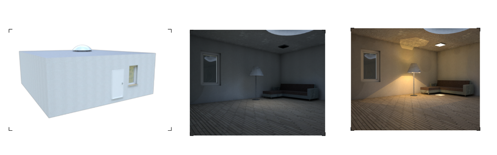

If I open your file and , for example, choose, the HDRI " Bäume 01 GS.hdr" in the german library I get the following result. The first interior is with only HDRI, the second is with lights switched on. You can try different HDRI:s, add or remove lamps and change the materials to experiment how this affects the render.

the file is a test object 😉
