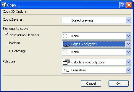

You can also generate a 3D top view with just the elements on that you want to cast shadows.
Then place a 2D marquee around it and copy just the shadows.
these can then be pasted into the floor plan in what ever layer you want so you can turn them on or off.
Just remember that these shadows will not change as you alter your design unlike a 3D document which is live.

ngoldie
I was wondering where the 3D copy option was, I can't seem to find it anywhere?
Thanks,
Naomi
Archicad 20
MacBook Pro - laptop
You need to be in the 3D window and have it set to the 'Vectorial Engine'.
Doesn't work in OpenGL.
Then place a 2D marquee.
Then CTRL+C and the dialogue will appear.
