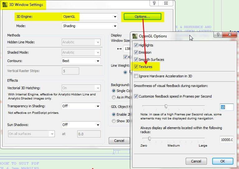

Also make sure that the 'Textures' option is turned on for the OpenGL options in the 3D Window Settings dialogue.
It should be on by default.
