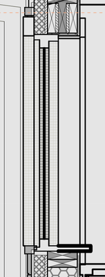

Thanks you again Francois for your thorough and exemplary explanation of how a window uses pens, and how each part of the window can have pen assigned to it as a "cut line." The problem we're having, I think, is in the definition of "cut line." In my understanding, as architect, a cut line is a bold line that that traces the edge of the thing being cut at the line of the cut. Or put another equally obtuse way, the cut line traces the edge where the thing becomes not the thing, (or where the thing thing touches the air. )
In a window (and this is not exclusive to windows. It is representative of the problem but certainly not the only example), the "cut lines" are not correct cut
lines.
In the first image below, ignore everything except the stool and "cut line of the stool." On the bottom, the cut continues from the outside to the inside of wall. It should not do this. It is not a correct cut line and there is no setting to make it correct. This is a problem that plagues "cut lines" through the software. If you look to the second image, I have drawn a cut line over the window with the line tool. It's worth noting how cut line turns the corner countertop and continues to trace the line where thing and the air meet. I also drew in secondary cut line on the interior of the casework at a lighter lineweight, signifying a cut that is secondary to the primary. This is what the cut lines in the model should look like. The 2d drawings that come directly from the model should be in essentially indistinguishable from an actual 2d drawing drawn with correct ciut lines. I've never seen a BIM program accomplish this, but I have to say at the moment Revit is a hell of a lot closer. In Revit, you can change the pen / lineweight of each individual line segment in any view, and you don't even have to use a pet palette. But I'm straying from my original point. Cut lines not hand cranks!

I think you could accomplish the cut line that I want, as well as other lineweights that could be called something like strong edges (edge of a building) or weaker edges (the edge of a cabinet) or any other of several conditions, if you could classify the individual lines in a drawings as cut line, strong edge, weak edge etc. and each classification could have an override where you could decide exactly what lineweight you want. Or just be able to select the line and change the pen. The key to this working though is the granularity and specificity to select and change every single line segment in every plan, section, elevation, and whatnot.. Every line in every drawing. Otherwise it's just another half finished half measure and I think there are enough of those already.

Fantastic @joyalinearch. Your question is now crystal clear 🤓 with the 1st image and explanatory notes. Your 2nd image and comment notes is a good suggestion of what you require in output and even a possible approach, nice.
From your 2nd image, I can see where you're coming from. Although this approach to drawing convention is not a common standard, I have come across designers that prefer this 2D style, especially for smaller scale drawings (ie. 1:100 / 1:50). And yes, this is not all automatic in Archicad (at the moment 😉). When detailing to larger scales (ie. 1:10 / 1:5 / 1:1) are mostly done with the structural element cut lines are stronger than that of finishes and other non structural elements (something Archicad automatically do very well I think). I guess from a programming & feature approach it's a trade-off.
OPTION 1:
Just a thought in the meantime (that I would like to test myself), is to see if a workflow of using a Detail (auto 2D of the model) of the Section / Plan would be faster than manually re-tracing the outline elements. I suspect just selecting the particular edge lines in the (auto 2D) Detail and changing their line pen would at least save time already (and grouping them while you have them selected would save more time). To not loose these lines on the detail when the model updates the detail (fortunately always a manual command), I would copy this new group and paste them over their origin + move these copies to a unique layer to easily isolate them. These copies will not be touched or altered when you run model update on the Detail view like the original lines would do. From there you simply need to copy the new / changed lines to your unique "Cut Line" layer after model updates. You can even use the auto 2D Detail just to get the outline cut lines to copy over live Sections / Plans to that unique "Cut Line" layer.
Still not an ideal BIM-like workflow, but surely could save time vs. manual tracing I believe.
OPTION 2: (I'm thinking probably the preferred solution for now)
Another approach that could also work (perhaps even automatically) is creating a LIVE 3D Section / Plan where ie. Composite skins are not shown (just showing the outer lines of elements with a transparent Fill), + Windows & Doors show lower detail via Model View Options + then use Graphic Overrides to show all those lines with the same Solid Line Type + Pen number.
You can then overlay this "lines only, transparent" drawing View as a separate View over the "normal: live 3D View on your Layout. You'll do all your text, labels, dimensions, etc on the live 3D View. The "lines only, transparent" drawing View will just be on your Layout to print that nice strong Cut Line you want (and it will be Automatic! & Live! Directly! from the 3D model 💪😃🤙).
PS: I don't think I'll get to testing this before the year ends, but I have actually used this "lines only, transparent" drawing View overlay on my Layouts before, although for a different purpose, while writing this I think this 2nd workflow could be a solution for your case as well.
What do you think? I'd love to hear what you think or get from testing these.
