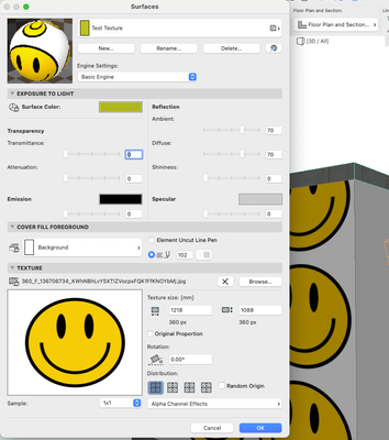

How can we import a custom material /texture for walls and use the custom material through Add-On code? Is it possible to simply provide the URL of the texture?
Update -> Have added a screen shot of the custom image import for materials that I mentioned above.
Thank you,
Kency
