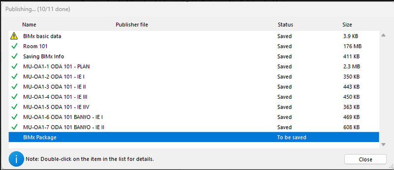

Archicad 27 BIMx Package to be saved Problem
Hello!
I have a problem when trying to publish a BIMx model. I have set everything right and when I hit publish it processes and saves the plan and section designs, as well as the BIMx info but when it reaches the 11th and final step which is the BIMx Package it seems to stop processing, and the message writes: to be saved. When I doubleclick on that it says that it has not been processed yet, but there is no progress as time goes by, as there is no option of stoping or pausing the process , only the close option for the window.
How could I resolve this?

Click on the yellow warning triangle next to BIMx basic data.
Does that offer any clues?
Sefa Yakut
The yellow warning triangle next to BIMx Basic Data only warns about the preview photo that needs to be added to the project. When I add any preview photo to the project from the project information, the warning sign disappears , but this does not solve the problem "to be saved."
OK thanks.
So now the question is where is it saving that BIMx package to.
Are you saving to your local drive or the BIMX transfer site?
If it is the BIMX transfer site, maybe it is not getting through.
Can you access it yourself?

I see that the BIMx Package is created when saving a file locally (with or without uploading it to the BIMx Transfer Site). @Sefa Yakut could you please provide some further information to help us narrow down the issue:
  • Do you experience this problem with all projects or only with a specific one?
  • Does it happen on multiple devices?
If the issue happens only with one project, I'd like to ask you to share the PLA with us by sending it to [email protected].

Hi, I tried many variant to solve this problem, even installed other archicad version and finally i realized that the problem is just in the language of the name of  publishing model. Rename it in english language and retry to publish hipermodel again.
SB projekts
Language problem! Not only model name. All your folders must use only english letters.
