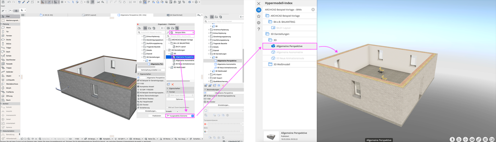

please make sure, that you did not only export a selection in the BIMx publisher set. You need to export the whole content of the publisher set.
If you only export a selection the BIMx Hyper Index will still show all of the names of the added views of your original publisher set. However, since you did not export all the 2D und 3D views, there will be missing views in your BIMx model.
Addition:
Exporting a selection can be used to update an already existing BIMx model.

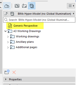

Did you include a 3D view in the publisher set for your hyper-model?
Hi, yes I did, but it gets placed on the layout, not being viewable as 3D
Your Publisher set properties are set like this? ...

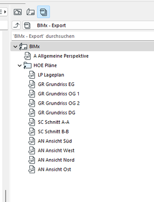

I'm having a similar issue.  Difference is my BimX model doesn't even populate the 3D views, Screen shot of the publisher set list attached.  Going to try and delete the current bimx set and re built the publisher set, then reload to the model transfer site.
