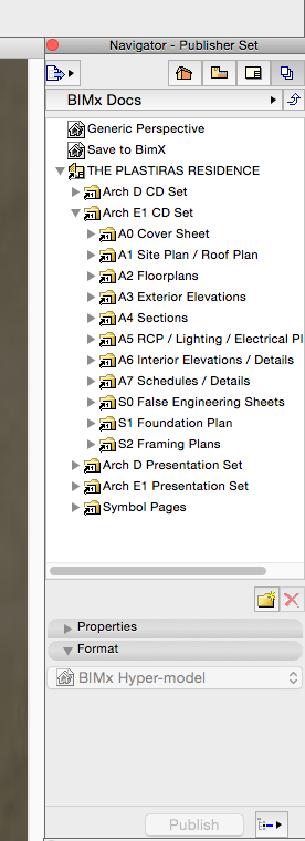

laszlonagy wrote:
The BIMx Hyper Model is identified by the Name of the Publisher Set from which the model is created (this is the same Name the user sees in the Project List in the BIMx app). So the Hyper Model is not identified by the name of the resulting BIMx file. Therefore the name of the saved BIMX file can be freely modified to carry version/design option etc. information, and one does not have to pay the 50 USD each time the name of the BIMx file is different.
This is even true if you saved your Project file under a new name (e.g. in the SD, DD, CD phases) with the name of the Publisher Set staying the same.
Still not clear on this...so in the instance shown here, is the BIMx Hyper Model identified as "BIMx Docs" or "Save to BIMx' (the 3D view used for the save) or possible "The Plastiras Residence"?
I don't want to be making a bunch of mistakes at $50 USD a pop.
Thanks for the help.
I don't have BIMx PRO on my machine, but my understanding is that it is the name of the Publisher Set that identifies the BIMx Hyper-Model. Then each saved 3D Viewpoint item in the Publisher Set will be a 3D Model within BIMx that you can view.
So in your example, the generated BIMx file (identified by the "BIMx Docs" name) would have two 3D Models: "General Perspective" and "Save to Bimx".
(But as I said I cannot verify it since I don't have BIMx PRO - or a smart phone or tablet for that matter).
