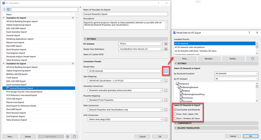

Aaron, the option marked in the screenshot are the ones I am aware of that export 2D elements as part of the IFC file. I have not tried it so if you do, I would be interested in the result.

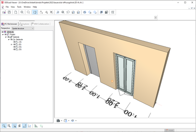

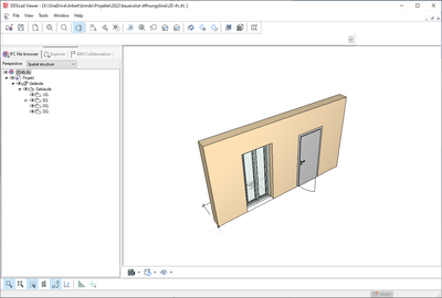

DdsViewer show the opening-lines

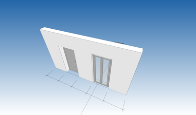

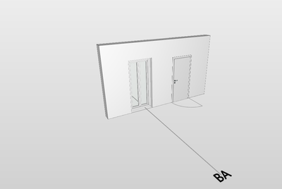

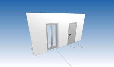

BIMCollab Zoom and Solibri only interpret the opening lines of the doors
Are there other ideas to put entities to the sash of a window, that we can represent the opening style in the model?
