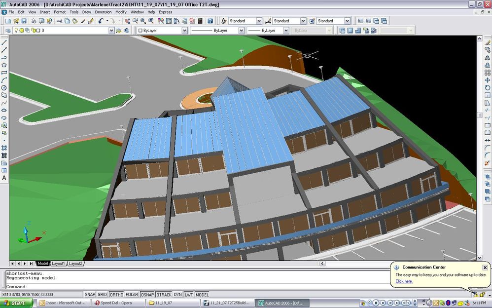

I have a problem exporting an ArchiCAD V 11 model into AutoCAD 3D. Attached is the image that I saved from ArchiCAD V 11.
I am working with ArchiCAD USA V 11 - Build 1033.
I am using the same DWG translator settings in both the versions, but still with no luck.
Thanks in advance.

Here is the image of the same project that I saved from ArchiCAD v 10 before migrating the project to Version 11.

I don't know if it helps. but you're 3 hotfixes behind. Help >Check for updates.
Srinivas
thanks for the response, I was not aware that I am 3 hotfixes behind intentinally skipped one of the hotfix because it had problems, I will download the latest one and get back

Srinivas
Checked with the latest build, but with no luck.
Did any one had this problem?

Thomas Holm
I haven't seen it. I think you should report it as a bug through your reseller. If possible, supply both your .pln, any custom materials, your saved translator and the dwg output you get.
