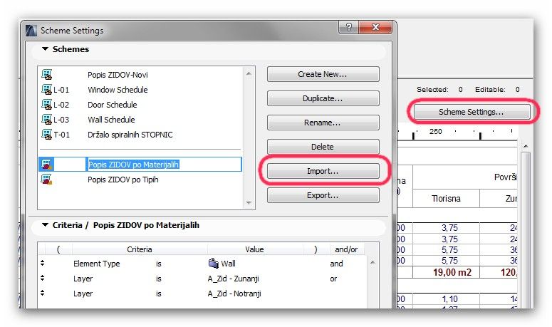

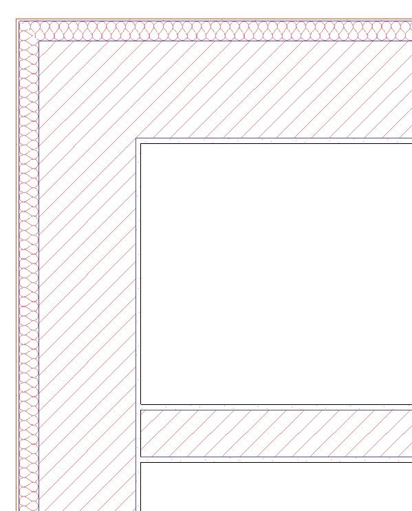

This are my schedules for a composite walls:
1. Wall Type
2. Wall Materials
This are my composite walls:
Thank you for the attachment Andro.
Where should I put these two .xml files? Or how can I open them?
I haven't checked the files but I guess you will have to import them in the Scheme Setup Dialog where you define the settings for your Schedules.
Open one of the available schedules, pick the button "Scheme Settings", then "Import" and select one of mine 2 schedules, press Open.

Andro does these .xml files work only for your composite wall?
Because in my case, when I import your files I get only Headings, no numbers data available. What am I doing wrong?

First thing: go to Scheme Settings > Criteria and check the Layer values, when I imported the file both Layer values were MISSING. This worked in AC 15, in AC 12 I got an error message that the XML file is corrupted when trying to import.

Also, you can use the easy to get data from a wall schedule (surface area for example) and export the schedule to Microsoft Excel where that data can be use in formulas to generate the schedules you really want.
Mine schedules were made in AC14. You must pick the button "Scheme Settings", then set the right Layers where your Walls are on.
They are made only for Composite Walls!
