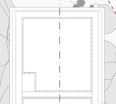

Hello everyone,
I have an issue when publishing a DWG with how the fills are displayed. Where as in the PDF export of the same layout everything seems correct and all elements are shown correctly, the DWG export randomly places elements above others (in floor plan) making the export a mess that you cannot use. It is making some fills transparent just in the DWG I guess.
So, the issue is not regarding display order as the view itself and PDF export are correct. I beleive that it has to do with DWG translators or pens used in background fills or something else. I tried different alternatives regarding these and did not helped.
Anyone actually knowing how this should work?
DWG:
PDF:
Thnak you in advance.
1 Reply 1
Sefa Yakut
Hello,
Did you make a subtraction operation on the fill using the subtract method here? It sounds weird, but I noticed the other day that when you subtract from polygon on the fill, the fill starts to show everything in the background after DWG conversion.
