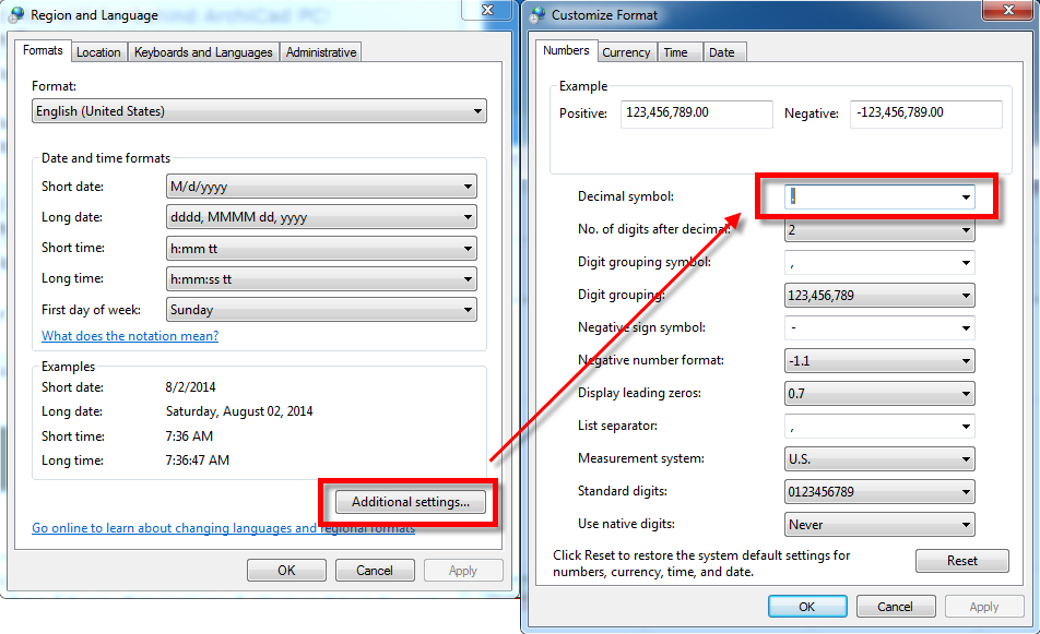

Hello, I know it is a very old topic but I have the same problem on windows7.
On my home computer archicad doesn't recognize "." when I type dimensions I always have tu use "," instead and it is verry verry anoying because I work very fast and once every 5 or so times I still press "." and I end up with crazy dimensions instead of 1.3 i get 13... Does anyone have any ideas on how to fix this?

On Windows 7, here is the system setting where you can change the Decimal point.
After changing it, I think you will have to restart ArchiCAD for it to read the new setting.
