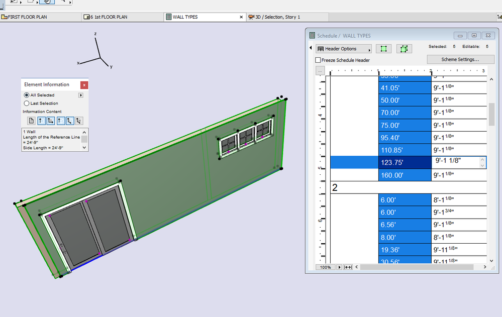

Length of Composit not correct in Schedule ?
Why would this wall be reported as 123.75' long at the reference line when it is actually only 24.75' long ?
3 Replies 3
Steve,
I can´t reproduce your issue. But I notate that the wrong value is exactly 5× the lenght of the wall.
andro55 wrote:
Steve,
There may be 5 identical walls in the same place or throughout the plan.
As the length and heights are identical they are being summed together.
Untick the box for 'Show uniform items as a single entry' or add an extra field like an ID that is unique to each wall.
Steve Jepson
Merge Uniform Items box is not checked and all walls do have an ID they are sorted for. Mysterious reporting in the schedule is no longer there. So problem is gone for now. ?
Thanks for the tip about the Merge Uniform Items box. I didn't think of that.
I used the Select in 3D tool in the schedule to view this wall. You would think that the length from the Element Info tool would be the same as in the schedule. ?
