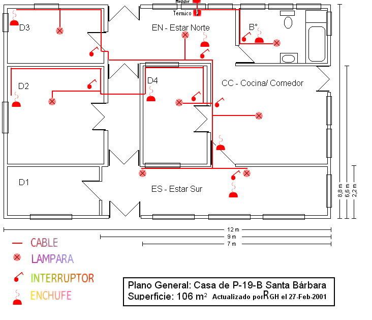

Does anyone knows how to create MEP axonometric views that are commonly used by engineers for Plumbing systems?
Showing only lines instead of the whole pipe with different line types for each system?

The problem is that this is the standard for construction documents in Mexico and also because it is not used to plot color plans for construction due to most of the plans that are on site are common photocopies of the original. So basically the contractors are asking me to deliver the information like this.
