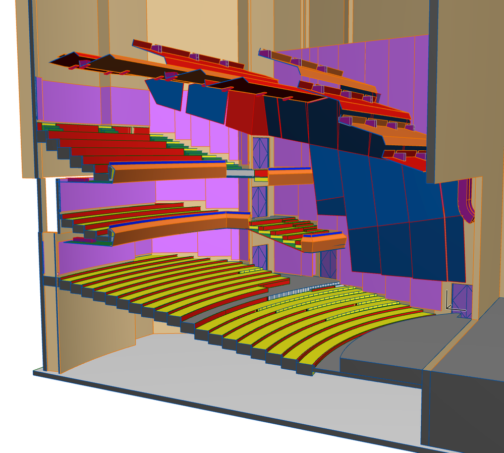

I did try it briefly and noticed that slabs with curved edges do no import correctly. Did try all the defined exports for Tekla in AC with the same result.

Eduardo Rolon
and how it looks in BimSight
