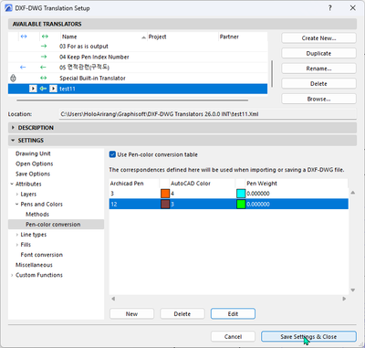

place External Drawing vs Attach Xref. about the Pen settings.
LeeJaeYoung
1. I would like to know about place External Drawing.... vs Attach Xref.
What's the difference between the two?
2. I want to know about the Pen settings.
There was no problem with merging...
Both don't seem to be set up.
AC27 on window 11

2-1. I don't know what the view translator does in xref manager.
No matter how much I change it, nothing changes.
Even if you change it in the dxf-dwg translation setup, the input xref has no effect.
In other words, detach the xref and call it again, it seems to be resolved.
