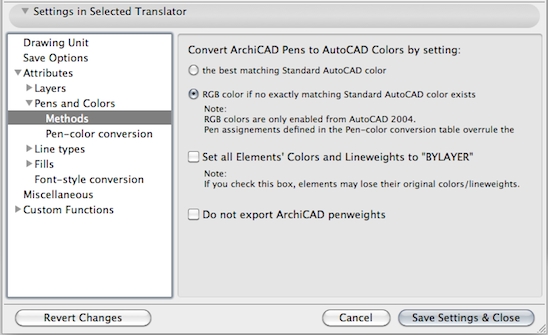

Pens and Colors
Archicad Pen Colors are configurable, while AutoCAD’s pen number association with colors cannot be modified. You can convert Archicad Pens to AutoCAD Colors by searching for the best color match or setting up a conversion dictionary.
Methods
Pen Methods match Archicad Pens to AutoCAD Colors
  • Convert Archicad Pens to AutoCAD colors by setting:- The best matching standard AutoCAD color. Every Archicad pen will be mapped to the AutoCAD color with the most similar color (RGB) components. - RGB color if no exactly matching AutoCAD color exists. While Archicad pens can be set to any color, AutoCAD has set pen colors that cannot be changed. In AutoCAD 2004 and later versions, it is possible to define further pen colors by specifying RGB values for them. These pens will have a pen index number of 256 or higher. If a color with the exact RGB value is not found then it is exported by the RGB value, with a pen index number higher than 256. This option is not available when exporting to DWG 2000 or 2002 formats.
  • Set all elements' colors and line weights to "BYLAYER": this option overrides the convert Archicad pens to AutoCAD colors option, and every saved element's color will be set to BYLAYER. When the AutoCAD user changes the color attached to a layer, everything on that layer will change its color accordingly.
  • Do not export Archicad pen weights: elements will be exported with line weights of 0.00 mm.
Pen-color conversion
Color pairs defined in the pen-color conversion dictionary will take precedence over the automatic conversion methods set in the Pen Methods. When exporting a DWG, Archicad pens will be mapped to the AutoCAD color with the most similar color (RGB) components, except where the pen is defined in the conversion table. This table pairs Archicad pens with AutoCAD colors. During export, the ID number of the pens will be converted according to this table. The pairs defined in the dictionary will take precedence over automatic conversion methods. The pen weights are not used during DWG export.

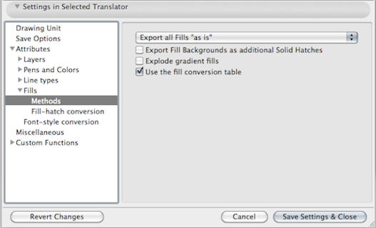

Fills
Archicad fill patterns can be saved as solid fills. You can also export fill backgrounds as additional polygons (as this feature is not supported by AutoCAD).
Methods
- Export all fill as "SOLID": all fills will be exported as solid fills. In case the dwg contains two overlapping fills, a solid (from the background) and a patterned (from the foreground). The empty fills are exported as solid fills, except the transparent ones, in this case, they will be boundary polylines. - Export symbol fills as "SOLID": all symbol fills will be exported as solid fills. In case the DWG contains only solid fills from the foreground (the pattern is converted to solid), and the background info is lost. The empty fills are exported as solid fills, except the transparent ones, in this case, they will be boundary polylines. - Export all fill "as is": Archicad fills will be recreated in AutoCAD to maintain the same appearance.
  • Export fill backgrounds as additional solid hatches: Archicad fill patterns have a separate background fill, whereas AutoCAD fills are transparent between the pattern lines. This option allows the same appearance in the DWG by creating an extra fill for the background. Transparent backgrounds will not be exported. Note that the option to export fills as “SOLID” disables this option.
  • Explode gradient fills: gradient fills will be exploded into separate components. Gradient fills with transparent backgrounds will also be exploded.
  • Use the fill conversion table: the conversion table on the next page of the translator will be used.
Fill-Hatch Conversion Table
From Archicad 12 the DWG translator can convert Archicad fills to specified AutoCAD hatch types. Create a new table row by pressing the "New" button.
This requires that a template file is specified in the Save Options and that the template file includes at least one placed instance of the desired hatch. The Archicad Fill Type can be selected from the drop-down menu, which will be converted into the AutoCAD Hatch pattern, which can be selected in the drop-down menu displaying hatches used in the template. Read more about Line and Fill Normalization

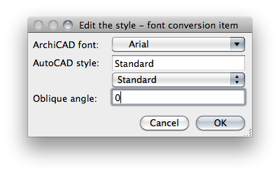

Font-Style Conversion
When an Archicad Project is saved as DXF/DWG, Texts in the resulting file may differ from the way they looked in Archicad. For example, the spacing of Texts may be different, so Texts block are not the same length or size. Furthermore, font names are stored differently in DXF/DWG files and in Archicad. Even when one-by-one font matching is possible, a dictionary is necessary. (On Windows, Archicad supports all available fonts including those installed by AutoCAD).
When exporting a DWG, if a text's font is listed in the dictionary, it will be converted according to the conversion table, from the Archicad style to the AutoCAD style. The Archicad font can be selected in the drop-down menu. The AutoCAD style can be selected from the drop-down list if a template file is specified in the Save Options. With the oblique angle option, you can set the degree value of the font. If the slant parameter is 15 (15 degrees) or greater, the exported text will be in italics. Usually, an italic style has an oblique angle of 75 degrees. Unless a template file is selected, the style will use the AutoCAD counterpart of the Archicad font. (A font conversion file specifies the best match, regardless of the platform Archicad is running on).

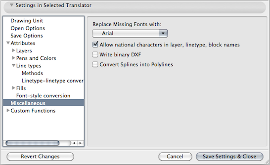

Miscellaneous
This group of settings contains options for Font conversion, spline convert, and the opportunity for purging unused Attributes.
  • Allow national characters in the layer, line type, and block names: Use this setting to keep localized characters when DWGs are exported for use within the same national environment. Unchecking this option results in letters being exported without accents/diacritics and some special characters will be replaced with underscores.
  • Write binary DXF: This compressed version of DXF takes up about half the space of the text DXF format. However, this format is still not as compact as when exporting to DWG.
  • Convert splines into polylines: Check this box to convert Splines into Polylines in Archicad.
    Archicad will approximate AutoCAD Spline using a series of connected straight-line segments (a Polyline). If this box is unchecked, AutoCAD Splines are converted into Archicad Splines.
  • Purge all unused attributes: When saving an Archicad file as DWG, only the Archicad attributes used in the project will be exported. This is an automatic process, reducing file size.
If a template file has been specified in the Save Options, all attributes from the template file will be saved as part of the DWG project, regardless of whether they are used or not, if this option is not checked. Use this option to purge the unused attributes from the template file.
