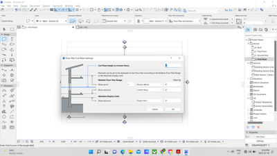

The walls are not visible in the floor plan.
LeeJaeYoung
AC27 on window 11
5 REPLIES 5
Mjules
Mentor

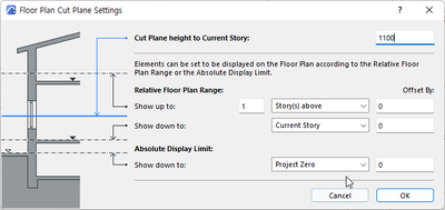

@LeeJaeYoung Check out your Floor Plan Cut Plane Settings:

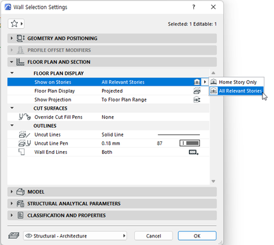

All Relevant Stories
The element will be shown and editable on all stories which it physically intersects. When available, this will be your preferred option most of the time.
"it physically intersects" Do you know what this means?
Do you have anything to do with this?
AC27 on window 11
@LeeJaeYoung I don't know why you'd like to intersect the view plans. In case of the tower you show as an example, the intersected floor plans will be massive. It's something you can also do in Archicad if you want even when it's not the logic of the software. I've mostly encountered this workflow in Revit, which, for me, is not the best way to work especially with towers.
