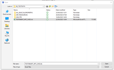

Is there anyone know with this DG::GetOpenFile() function, how to set its filter to be able to open only .pln or .pla type?
3 REPLIES 3
Joel Buehler
mmmh i can't find the GetOpenFile function in the documentation and neither in the DG_Test example.
are you maybe speaking of the Open File Dialog? Something like this:
When yes, the filter system for this dialog ist quite simple:
	//OPEN DIALOG UNISTRINGS SETTINGS
	const GS::UniString input = "Open Button... =)";
	const GS::UniString inputFilter = "Excel Files";
	const char* fileExtensions = "xls";
	//FILE TYPE MANAGER SETTINGS
	FTM::TypeID	retID;
	FTM::FileTypeManager ftman("xls");
	FTM::FileType type(nullptr, fileExtensions, 0, 0, 0);
	FTM::TypeID  id = FTM::FileTypeManager::SearchForType(type);
	if (id == FTM::UnknownType)
		id = ftman.AddType(type);
	//FILE DIALOG SETTINGS
	DG::FileDialog	dlg(DG::FileDialog::OpenFile); // Open only 1 file
	UIndex	i = dlg.AddFilter(id, DG::FileDialog::DisplayExtensions); // Force it on mac...
	dlg.SetFilterText(i, inputFilter);
	//INIT OF IO LOCATION
	IO::Location location;
	if (!dlg.Invoke())
		ACAPI_WriteReport("ERROR IN OPEN FILE DIALOG!", false);
	else
		location = dlg.GetSelectedFile();
                   // with the location you can start working on the file

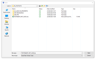

Hi Joel,
From your code below, the fileExtensions parameter can be only "xls". Which recently it could be "xls" or "xlsx", so how could it filter with both format?
	FTM::TypeID	retID;
like this:
	FTM::FileTypeManager	ftMan("Exel Files");
	FTM::GroupID			gid = ftMan.AddGroup("Excel Old Format");
	ftMan.AddType(FTM::FileType("ExcelOld", "xls", '    ', '    ', 0), gid);
	FTM::GroupID			gid2 = ftMan.AddGroup("Excel New Format");
	ftMan.AddType(FTM::FileType("ExcelNew", "xlsx", '    ', '    ', 0), gid2);
	DG::FileDialog  flDlg(DG::FileDialog::OpenFile);
	flDlg.AddFilter(gid);
	flDlg.AddFilter(gid2);
results in this:
