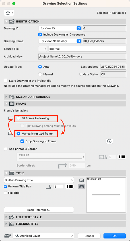

I have a problem with 3d views showing up as white/blank when placed on a layout. I have tried Fit frame to Drawing, Full Precision Preview etc and they are on Auto-update. If I right-click and pick "Open source view" it looks just as it should in the 3D window. They also appear blank when I publish, which is a big problem. Am I doing something wrong or is this a bug?

Open the drawing selection settings and switch between Fit frame to drawing and manually resize frame. (+ fit in window)

Cuba - does switching between Fit to frame and Manually resized frame fix the issue for you?
cuba
It does not always occur. If you have an empty frame, the drawing without a frame does appear somewhere far outside the drawing. By switching, the frame is around the drawing again, but it may be outside the layout. You just have to move it then. Sometimes this happens for several drawings on a layout, sometimes there is no problem. (only happend on ac27)

Nothing worked...except turning off and on the computer and change to fit frame to drawing...

had the exact issue with a guy in our office just then. placing a saved 3D window view into the layout resulted in a blank drawing. nothing worked. messing with the Drawing boundary & zoom didn't do anything. opening the source view (3D window) was OK -- no issues at all. pretty much everything that's been discussed in this thread.
the solution i proposed was to use a 3D Document version of the 3D view. this fixed it & the empty drawing error doesn't happen anymore.
