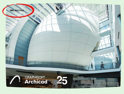

When you say English (Australian) you mean the AUS version of Archicad.
I don't have the latest build (3011) but I don't think that will make a difference.
So if you are running exactly the same Archicad as me, I don't know why I can copy & paste and you can't.
