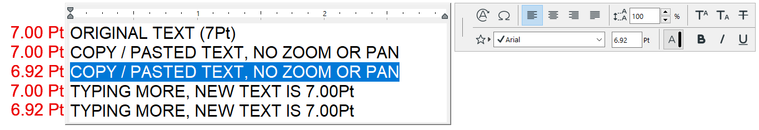

Copy / pasted text changes sizes, regardless of zooming or panning before pasting. This also happens whether i paste in a different text box or not. Below are some examples:
I pasted text in the same text box, after hitting enter, and it's 0.19 Pt larger. After pasting, i hit enter and continued to type: new text is also 0.19 Pt larger. That text, copy/pasted, (line 5) remained at 6.19 Pt.
(Could be related to leading / line spacing?)
Tried again; this time at a different original size. (7.00 Pt) This time the text was pasted 0.08 Pt smaller. After hitting enter, new text on the next line was back to 7.00 Pt. The fourth line of text copy / pasted (line 5) was 0.08 Pt smaller again.

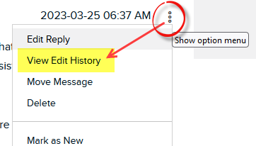

Related to better understanding the forums: it shows you edited my post at 10:53pm -- is there any way to view different versions of posts? ...Can moderators potentially change posts however they like without record of what was originally written? (No accusations here, just trying to make clear the capabilities and implications of a system. I'm confident whatever edits you made were for the sake of brevity.)
There still seems to be a problem.
Just tried in 26 (build 4019 -I don't have the latest preview installed).
It doesn't seem to be changing by as much as it did before, but it does change.
Even copy & paste within the same text box.
Regarding forum edits, I don't know if regular members can see the edits or not - click on the 3 dots and see if you have an option to view edit history.
It might be just a moderator permission.
If not I can assure you all Karl did was increase the size of the images you attached.
We will never alter the content of a post unless it is removing malicious content or web links, or maybe fix a spelling mistake or use the correct terminology.

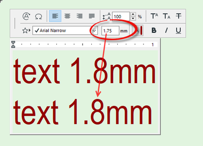

I have seen this one for a long time (reported during beta a while ago), but only when the Working Units are set to 4 decimals (8.0000 pt becomes 7.9999 pt after copy & paste).
David
David Maudlin / Architect
www.davidmaudlin.com
Digital Architecture
Thanks, David.  I can reproduce it now with the 4 decimal places and 8 point text.
Strangely, with 7 point text, no matter what I do, it always comes out 7.0000 point text.
And, also strangely, the OP used only 2 decimal places and was able to see the issue.
(My guess is that Archicad stores the text size internally in millimeters (everything is meters internally)... and point sizes being imperial based with 72 points to the inch and 8 point being 1/9th of an inch (1/9 being an infinitely repeating .11111... and the conversion factor from meters to inches being an irrational number) that all of the conversion results in some gross truncation and rounding error.  Might explain why this still isn't fixed, as changing the internal units for fonts could be a huge ordeal.  On the other hand, you'd think a copy/paste would copy and paste whatever pre-truncated/rounded metric value existed for the copy and paste exactly that so it should paste exactly matching the original.  The only way that wouldn't happen is if they unnecessarily converted the internal value multiple times.)
