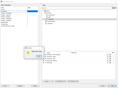

Running AC26 INT 4019 on Windows 10 and using the default template.
Deselecting a layer with a empty name field prompts a waring and reverts to the previous name. Closing the warning either through x or OK selects the layer. This seem to work as intended and is stable. Although it would be more intuitive if it reverted back to input in the empty name field (it would also make it consistent with how it works for folders in the top pane!).
However - if the layer is deselected either by either selecting a non-parent folder in the top pane or by changing from list view to folder view things become unstable as the layer item isn't visible. Sometimes it is possible to close the warning and another layer is selected. Sometimes the warning becomes unresponsive and AC crashes. Sometimes it is possible to close the warning but then AC crashes. Sometimes it is possible to use the dialog even when the warning is up. I can't find consistency in the behaviour but a crash can be forced within a few attempts.

We kindly ask you to contact your local Graphisoft distributor for investigation of this issue. You can find their contact information here: Get in Touch – Graphisoft.

It implies that this could be a bug and, thus, it should be investigated by our support team locally. You should provide them with detailed steps for reproduction and the affected file. If it happens to be a user error, they will be able to assist you and correct it. If it's proven to be a bug, support will report it to the dedicated team for a fix.

Alright. The thing is - that process is just too much of a inconvenience more so than the issue. I'm not going to put time on contacting my local support for something that isn't critical for my uptime. The issue and how to reproduce it in the default template is described here, it could be added that it holds for other folder organised attributes as well.
It seems to be an obvious bug. I will just leave it at that and note its connection to the conspicuously underdeveloped folder functionality and attribute interface.

Entering the an already existing name causes the same issue. And as a side note - having an empty name or an already existing name and pressing enter closes the settings dialog without a warning and reverts to the original name - giving the user no indication that the input was rejected.
